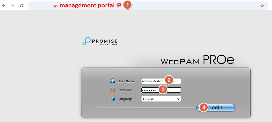

1].Login the WebPAM PROe
1.1] Open browser and put the management portal IP
1.2] put administrator account
1.3] default password is password

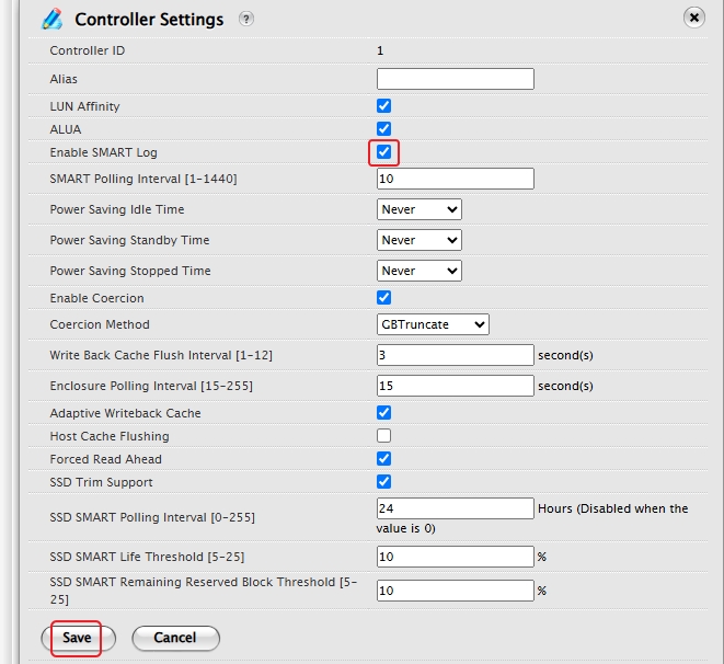

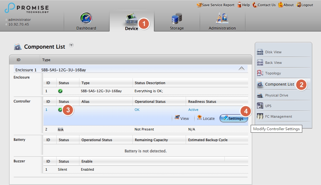

2].Enable SMART log.
Go to Devices > Component List > Controller > Settings > Controller settings

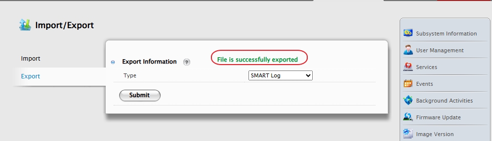

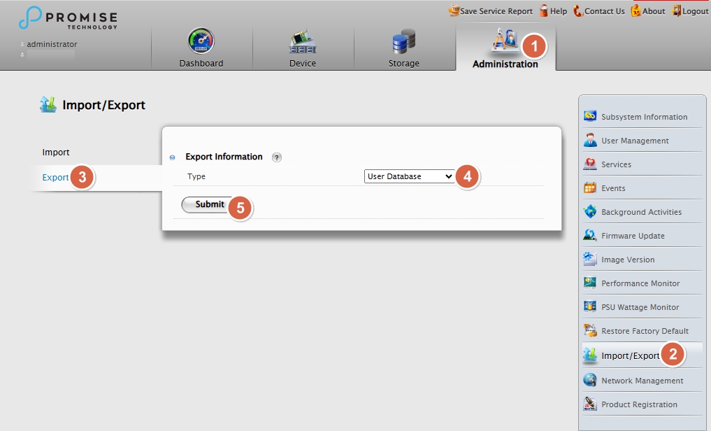

3].Export SMART log.
Go to Administration > Import/Export > Export > Select "SMART log" from Drop-down menu
