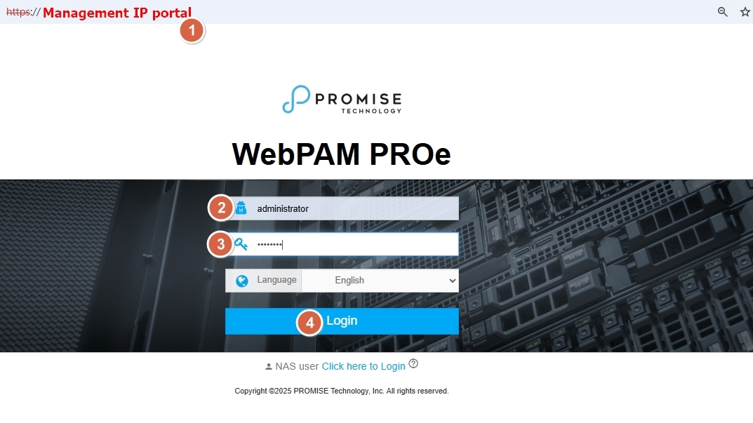

1].Login the WebPAM PROe
1.1] Open browser and put the management IP portal
1.2] put administrator account
1.3] default password is password

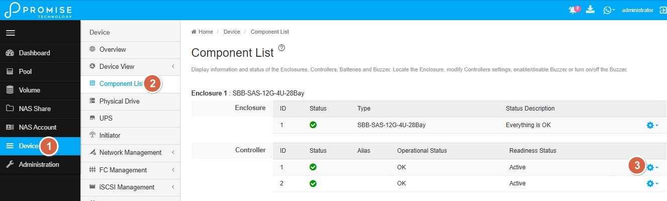

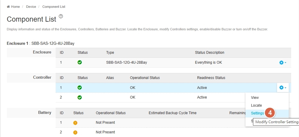

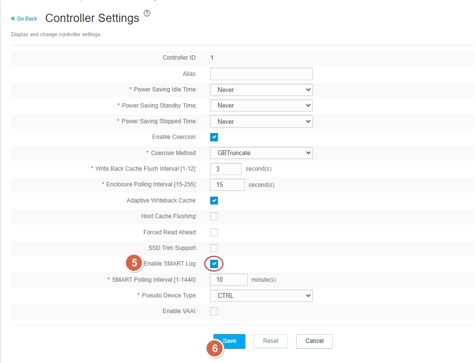

2].Enable SMART log.
Go to Devices > Component List > Controller > Setting > Controller settings

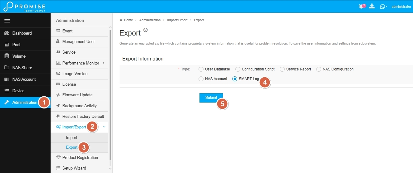

3].Export SMART log.
Go to Administration > Import/Export > Export > SMART log
