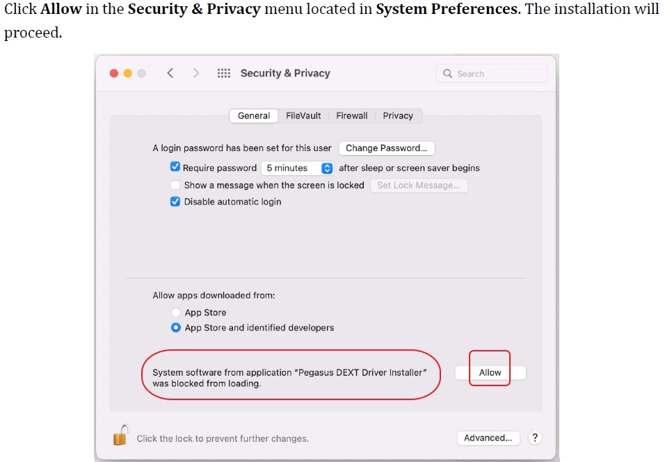

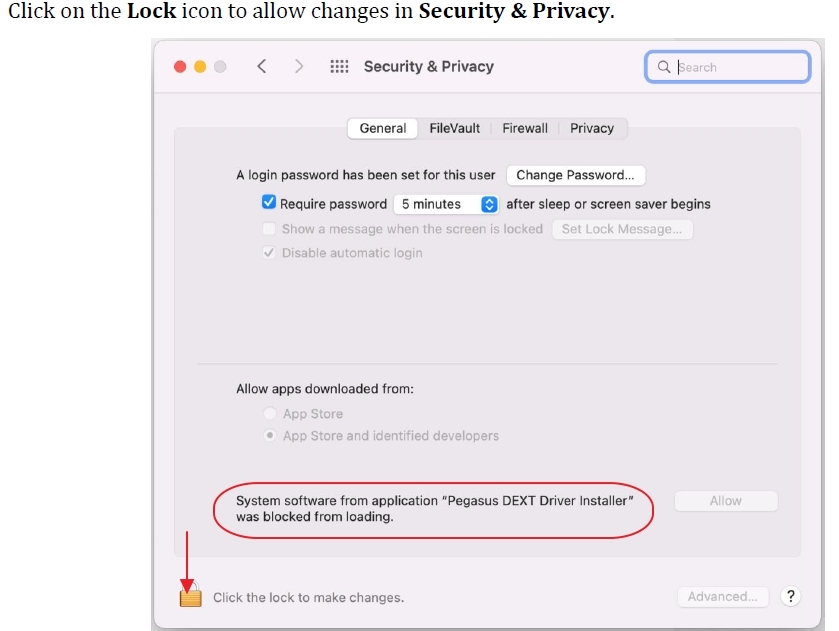

  • Click Install to initiate a standard installation, then enter your Mac password when prompted.
  • When the System Extension Blocked message appears:

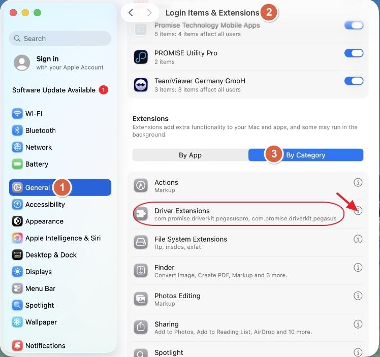

    • Open System Settings and navigate to General > Extensions > Driver Extensions.
    • Enable the Pegasus DEXT Driver Installer by entering your password again.
The method for enabling the DEXT driver varies depending on your Mac operating system version; you can refer to the installation guide.

Note : If the screenshot output below says "activated waiting for user" after entering systemextensionsctl list | grep pegasus , This indicates that the Pegasus driver is installed but requires manual approval in your Mac security settings before it can function properly. Allow the driver and restart your Mac . After rebooting, run the following command again (systemextensionsctl list | grep pegasus) to confirm the driver status says "activated enabled"
