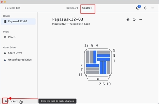

1].Click the lock to Unlock first after lunch the Promise Utility Pro
2].Click the Controls tab
3].Put the password of the login user

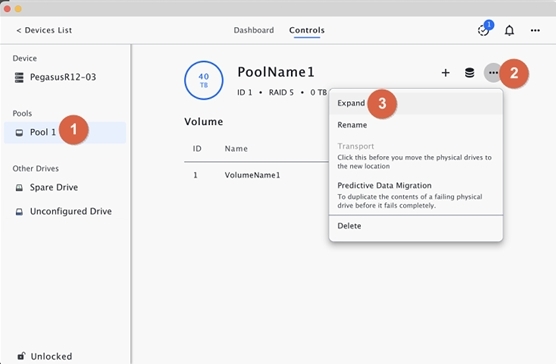

4]. Go to Pools tab and select your pool and then click Expand function

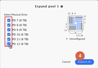

5].Select physical drives you would like to expand. For this case, original pool is with RAID5 level so you at least select 3 disks to expand the pool.

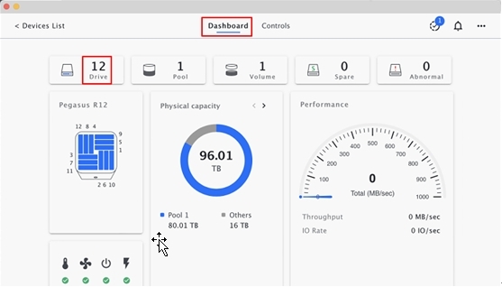

6].Check these drives for the pool at Dashboard tab when pool-expand is done.

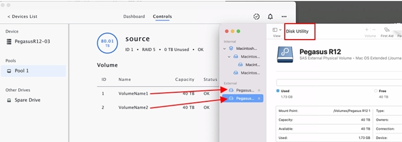

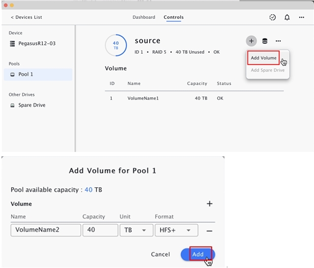

7]. Go to Pools tab and select your pool and then click Add Volume function
8].A new Pegasus Volume (VolumeName2) will be mounted after formatting it.
